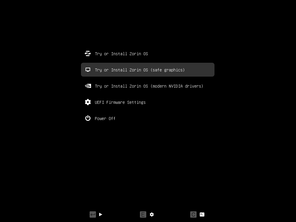

Black screen instead of booting
If you see a black screen after selecting the “Try or install Zorin OS” option at the USB Install Drive’s boot menu, the issue is most likely caused by a graphics-related error.

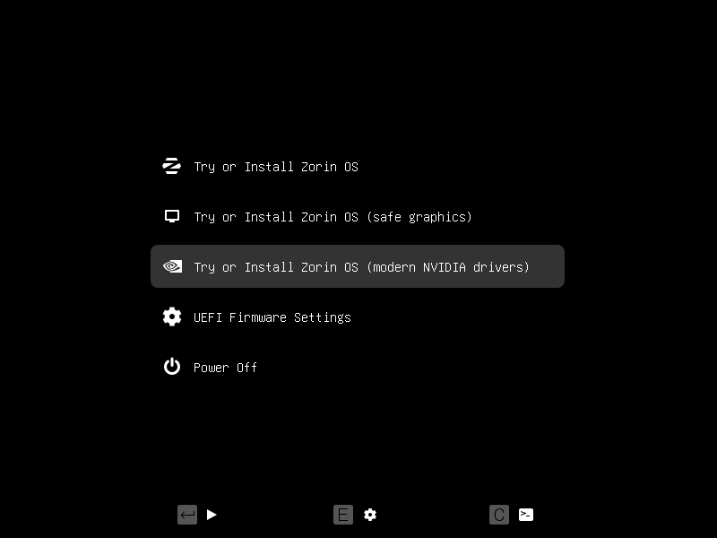

On computers with modern NVIDIA graphics cards
Select the “Try or Install Zorin OS (modern NVIDIA drivers)” option using the ↓ ↑ keys and press Enter to boot and install with the official NVIDIA proprietary graphics drivers. Please note that you may need to first disable your computer’s Secure Boot feature to enable the NVIDIA drivers fully.
This uses a modern version of the NVIDIA proprietary drivers, which only work with newer NVIDIA graphics cards (produced after 2013).
If your computer has an older NVIDIA graphics card and is unable to boot with the standard “Try or install Zorin OS” option, please follow the instructions in the On other computers section below.
On other computers
Please select the “Try or Install Zorin OS (safe graphics)” option using the ↓ ↑ keys and press Enter to boot.

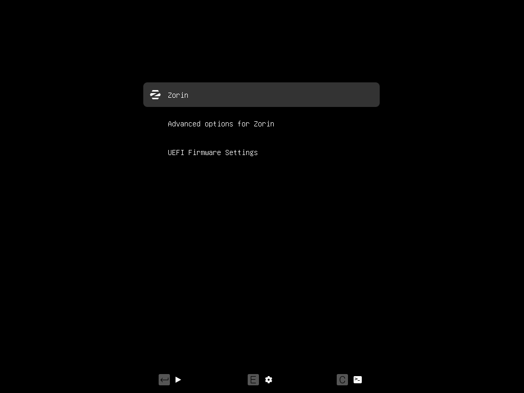

If the installation completes normally but you’re still unable to boot your installed copy of Zorin OS afterward, please follow these steps:
- If you selected the “Erase disk and install Zorin OS” option during the installation process, press either the Esc or Shift key after switching on the computer to access the boot menu.
- At the boot menu, highlight the “Zorin” option. This is usually the first item at the top of the boot menu.

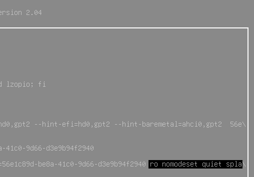

- Press the E key to temporarily edit the boot parameters.
- Use the ↓ ↑ ← → keys to move the cursor right after
roand beforequiet splashon the 2nd last line of text. - Type
nomodesethere so the text reads as follows:
- Press Ctrl + X to boot your installation of Zorin OS.

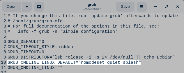

If your installed copy of Zorin OS is still unable to boot normally, you may need to set the system to use safe graphics mode permanently. To do so, please follow steps 1-6 above and then follow these instructions:
After logging into your user account and reaching the desktop, open the Zorin Menu → Utilities → Terminal.
Enter the following command into the Terminal:
gedit admin:///etc/default/grubIn the new Text Editor window, move the cursor to the line that looks like the following:
GRUB_CMDLINE_LINUX_DEFAULT="quiet splash"Add the text
nomodesetbeforequiet splashso this line looks like the following:
Save the file and close the Text Editor window.
sudo update-grubRestart your computer to apply the changes.
